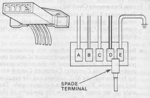

Assembly Line Diagnostic Link (ALDL)location:
1981 Model Procedure:
If you have the distinct honor of having one of the first Computer Command Control (CCC) systems put into an El Camino, use this method. I think it was first introduced in California in 80 and the rest of the U.S. got it in 81. The 80/81 CCC system is different from all other 5th Generation El Camino CCC systems.
This is the 1981 Assembly Line Diagnostic Link (ALDL)
In order to pull the stored codes do this:
1. With the ignition off, jumper the two far right terminals as shown in the picture. "D" is the diagnostic terminal and "E" is ground.
2. Turn on the ignition but do not start the engine.
3. The SES light will begin to flash a Trouble code 12. One flash, a short pause, and two flashes. There will be a longer pause and the Code 12 will repeat two more times.
4. The stored Trouble Codes will now flash. Each Code will be repeated three times. Write them down.
5. When Code 12 flashes again that indicates that there are no more stored Trouble Codes.

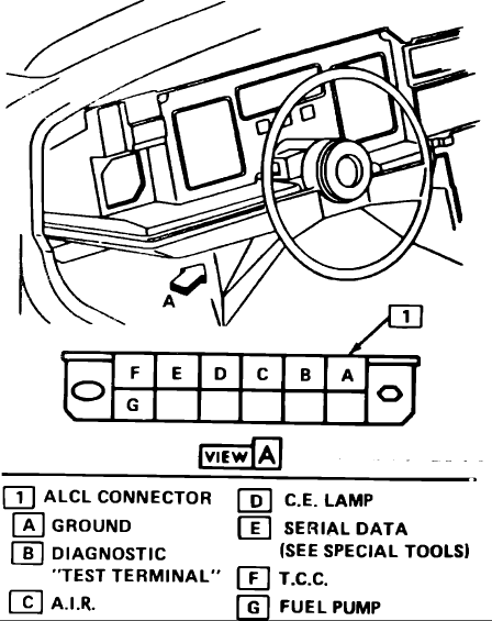

1982 And Later Model Procedure:
- Turn ignition switch to OFF position
- Locate Data Link Connector (ALDL).
- Jumper the A&B terminals using a paper clip or a jumper wire.
- Turn Ignition switch to ON position.
- Count the flashes on the "CHECK ENGINE" or "SERVICE ENGINE" light.
- FLASH, pause, FLASH, FLASH = code 12
Diagnostic trouble codes may be cleared by disconnecting the battery, or removing the ECM fuse for at least 20 seconds. Reconnect and recheck codes to confirm the repair.
