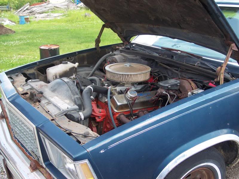

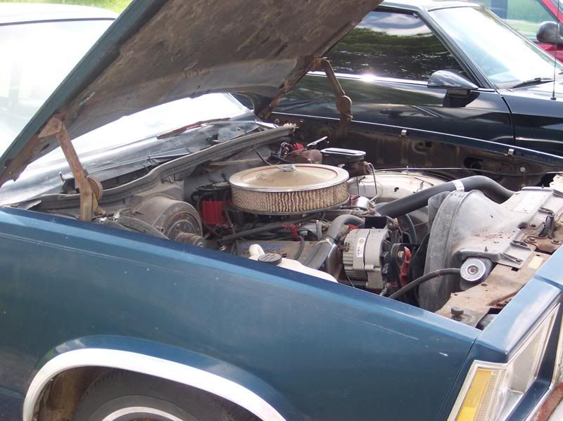

93 Posts
1979 El camino
Engine: 383 stroker
Trans: borg warner T-5 5-speed
Rear: 10 bolt GM Posi
Interior: terrible!!
Exterior: solid, but needs straightening.

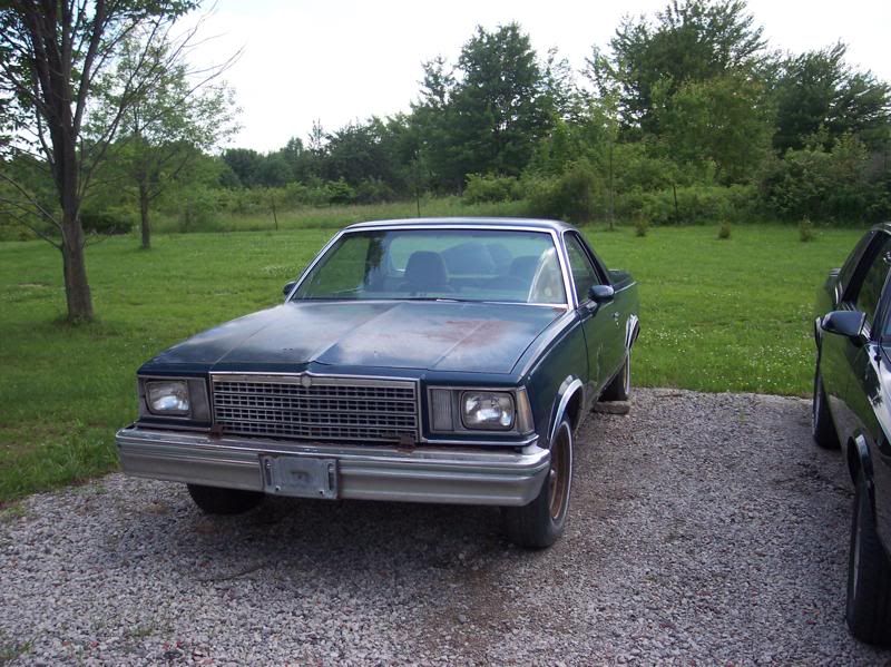

First pictures i saw of it

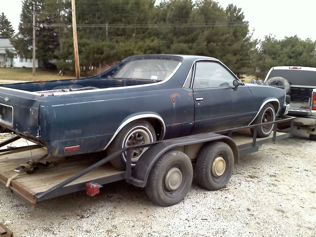

Bringing her home
Use Simple Green on the engine bay! Looks like a nice fixer up,but you didn't post pics of the interior...

looks like too small a balance for a 383. most 383 s use the wide 400 balancer. does it have a cut out section on the outer ring of the balancer. it could be internally balanced then would have a neutral balancer,but most dont go the 600$ extra for the heavy metal balance.either way a nice starting point. i just hate to see people ripped off when buying toys
