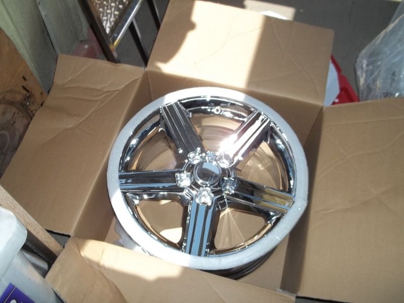

And to put the final touch after the engine and truck is repainted it wouldn't be right without new shoes:poke:
