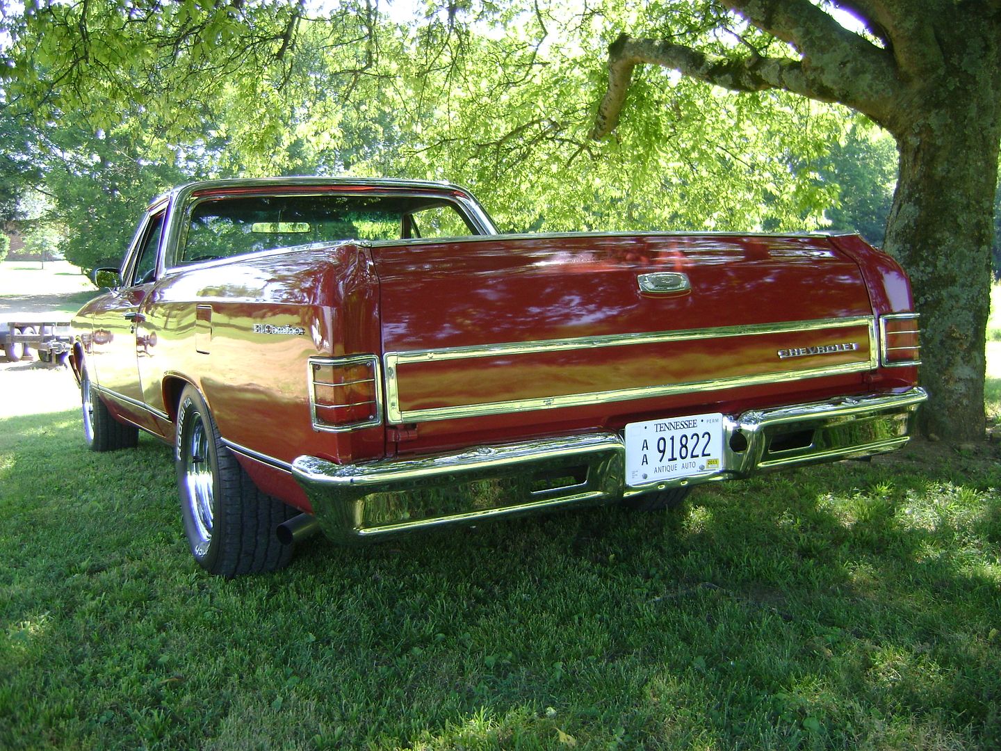

#24 ·
Yep...something else I need to work on. Wonder how difficult it would be to locate a manual tilt steering column?
This is the basic look I'm after. There may be a little autocross action in it's future. :wink2:
