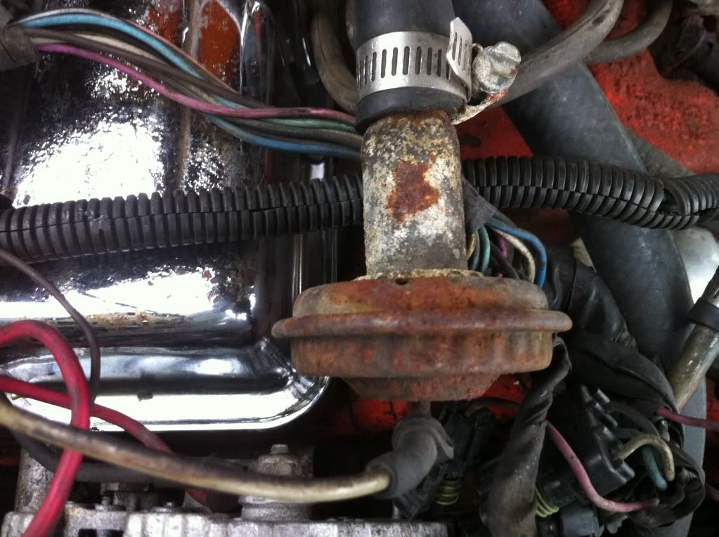

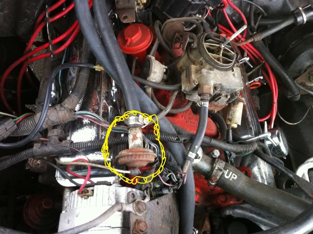

That's the heater control valve. It regulates the amount of heated antifreeze to flow through it. They are easy to replace.
72 Posts
thanks the engine is from a 77 camaro so not sure if this works the same for my car but im gonna get rid of the intake mounted valve and get one that is made for this year car, plastic so no rust, also cheaper, hopefully wont have to worry about it after the replace
1966 El Camino
2,050 Posts
Can't that be bypassed? I dont have it on my new engine.
It can be bypassed, when bypassed heated water flows unimpeded into the heater core, if the heater doors and controls are working properly this usually isnt an issue. The part is however easily installed so as long as the vacuum that actuates the valve gets there then there isnt any reason not to have one.
