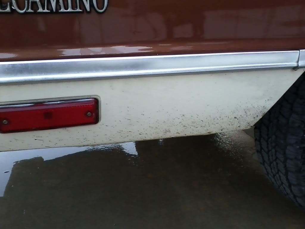

I noticed I had these black marks on either side of my El Camino. I suppose I kicked up some tar that was paved on the road recently. What's the best way I can remove these marks? I tried using some Goof-Off (it's safe for car paint) but it was to no avail.:neutral2:
I have had good luck removing tar and road grime with WD-40 and soft cotton towels.Let it soak a while and rub gently.That should work as well as any product you can buy.WD is based on kerosene which is an ingredient in the road tar.Just rub gently!!
I like R-M Pre-Kleano it's a wax remover/degreaser for paint prep. Costs about $40/gal so you might want to try the WD-40 first.

I would give a clay bar a try. I have never tried using it to remove tar, but it has removed everything else I have tried it on.
Get as much off with elbow grease as you can then hit it with the clay.

3M makes a great adhesive/automotive surface degreaser, comes in a red and white aerosol can. I've been using it for years, and it's 100% safe to use. Spray it on, let it soak for a few minutes, spray it again and rub it off with a cloth dampened by the spray. Works great!

I've heard of using a diesel soaked rag to saturate, soften & wipe off the black crap. I have not tried this myself.

Just plain old turpentine/paint thinner is about as safe and thorough as you're going to get. Won't touch your paint.

Plus 2 on the WD-40. I've done it many times. Follow Lockjaws instructions.
Be very careful following Lockjaws advice.. :poke:use your best judgment. But the wd-40 does work..

X2 on the WD 40
WD 40 works Great ! will not do damage to the paint,i have used it on my Trucks,and on my Harley ! :beer:
i use gas it takes it right off and doesnt harm good paint,just soak a rag in it and wipe it right off then wash and wax the area
