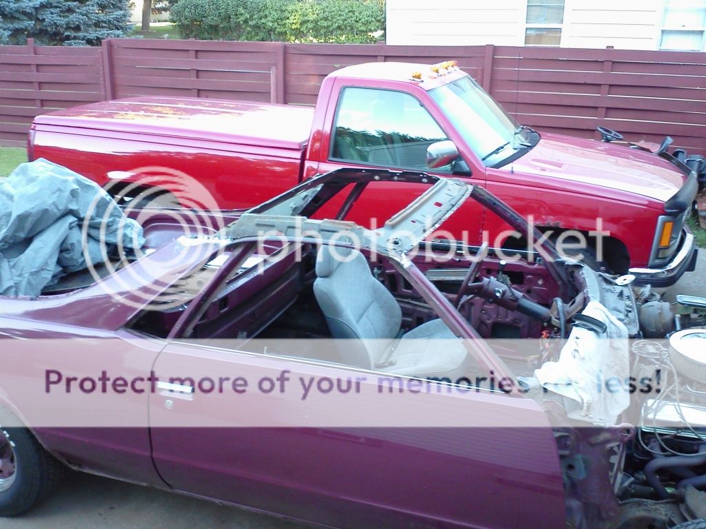

Now for the removal of the one on the car. Your going to want to remove all the glass, seals, weatherstripping and trim. Also it would be a good idea to remove all of the interior.
Basically the procedure is the same thing but it doesn't really matter if you damage the skin at all. Instead of cutting all the spot welds I used a cutoff wheel and ground them all down which was way faster. Just be careful not to damage any of the roof frame or other metal areas under the skin. The only thing I did differently than when I cut the donor skin off is where the skin attaches to the drip rail. I didn't want to damage my drip rails, so I very carefully ground down the roof skin with a cut off wheel on the top side in the drip rail channel till it all separated.
Then your left with and El Convertible! lol
That's where I'm at now. I still need to clean everything up, paint it, and replace some rotted spots. Will probably update this next week.
