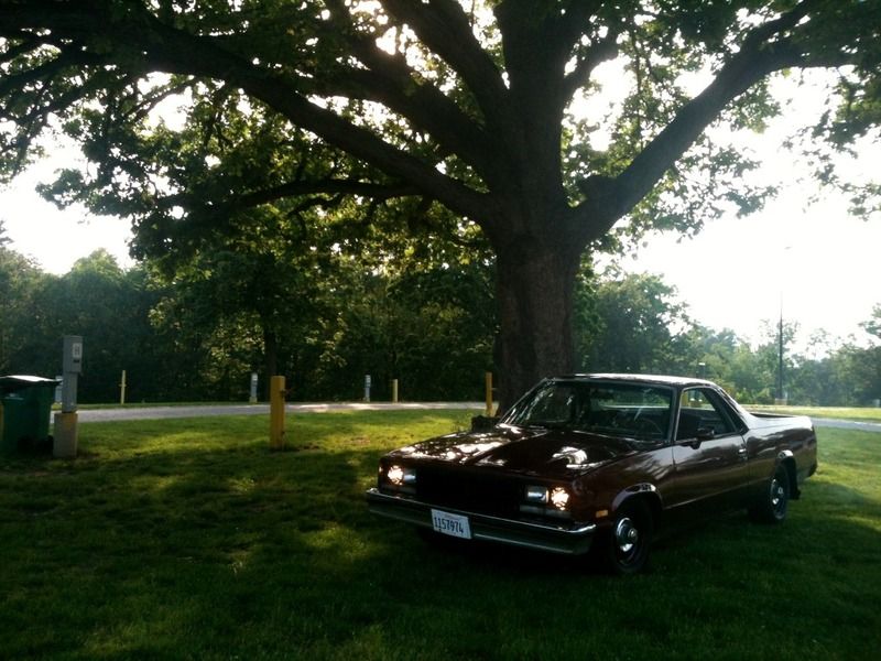

This use be a farm truck when i purchased it. The only work the guy mentioned doing to it within the last 5 years was a new carb, distributor cap and wires. Slowly i'm putting time and money into it. So far i've replaced the radiator, belts, tires, battery, windshield, and plan on working on the gaskets and new front shocks this week.
Currently i have idiot lights and at start up the only red light i get is the temp light and the service engine light stays on. I found a dash cluster from a 81 elco that i'm i thinking about snatching up. Until then can someone tell me what these wires go to? Should i reattach them or what:?:
