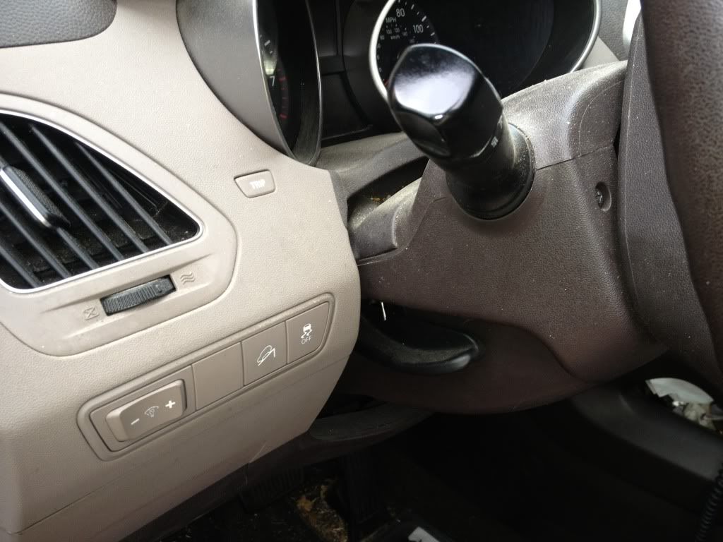

I have a teen who I have to hide my keys from for her's and the community's safety and my liability. I also had a kill switch installed on my 2012 Hyundai. $40 wish he had used a black switch
