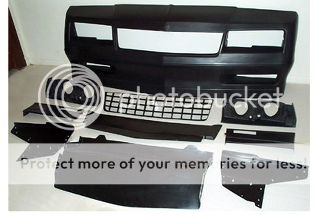

My front needs work and then I saw this kit what do you think? I know it's my choice but will this work with my 79 fenders on my 85 truck?? Bumper stay the same or need a Monte bumper:secret:
http://www.dankoreproductions.com/store/chevy-monte-carlo-ss/complete-kits-and-spoilers
Complete 10-pc Monte CARLO SS Kit – Fits all 1981-88 Monte Carlos
This complete fiberglass nose kit comes with everything you need to change over a standard Monte Carlo to an SS Nose. This high quality reproduction is super straight and fits very well. Lower spoiler is molded into the nose all as one piece. It does not require all of the support brackets and hardware that the rubber nose usually requires. Included in the kit is a 4 pc radiator shroud kit, a 2-pc headlight bucket kit and lower fender trim pieces. All parts install into factory bolt locations. Plastic grille is included and installs into fiberglass nose.
$849 I can shop the kit for better pricing or different brand/ junk yard find factory front clip???
I will also be adding a 4 inch cowl hood so I'm look'n for the EVIL look.:twisted:

Monte Carlo is different enough from El Camino that a Monte nose will not fit directly. That's why I got the nose for my car from Lauren Engineering. It was a good fit right out of the box, only needed a little fine tuning for a show quality fit. It's a solid piece, heavy fiberglass almost like a boat.

x2- Monte won't fit directly. Have to change to Monte fenders, doors, and then do body line modifications on the rear quarters. Much easier to buy an El Camino kit. I've installed two of the Honest Charley kits, and have been happy. They bought the ChooChoo rights, and have the original molds, etc.

will NOT fit(without the other mcSS components).you are better off buying the choo-choo repro as it would be cheaper,then having to piece to 2gether all mcSS components(hood fenders,nose,and doors.)neSSasary for "conversion"to bad you are a day short,as you could have scored a factory choo-choo nose from member "scarygary" for 300.00! nehoo i have 3 great cond complete extra front clips,and sets of power doors for my 6 SS's i own(yeah im a stock piler/parts hoarder!!!) if you are still determined to do the mcSS conversion,and have a shipping solution? i just recently sent a clip to australia and it was actually cheaper than the big retailers,and as the guy wanted the factory urethane(yuck!)opposed to the aftermarket fiberglass:dontknow:(much better in my oppinion,as it is easier to mod:nanawrench:)

IMO the Monte nose swap isn't worth the effort, unless you are given the parts for free. But for $850 for that kit you're better off putting that towards an Honest Charley nose.
