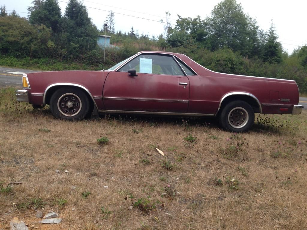

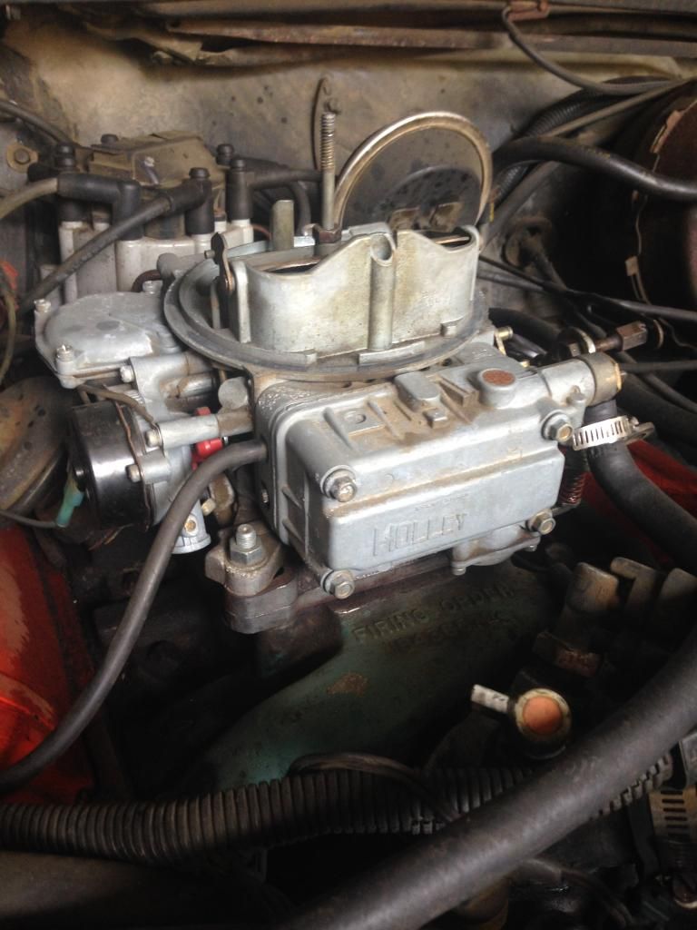

I purchased this 1981 El Camino about three weeks ago. It has the 305, a slapped on Holley carb, and TH200. The body is a little rough, but manageable. I may have to replace the driver's door. The frame looks great!
So far I've been working on cleaning it up. I've stripped the worn rubber trim off the belt line, and have started power washing 30 years of grime off the suspension/frame.
