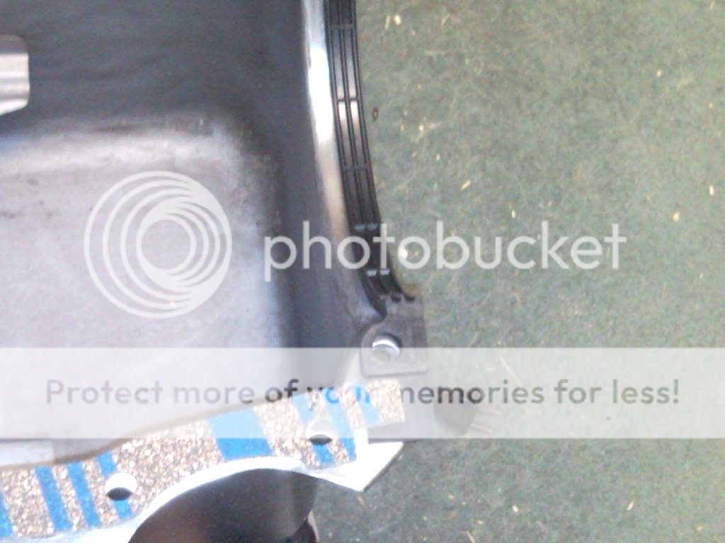

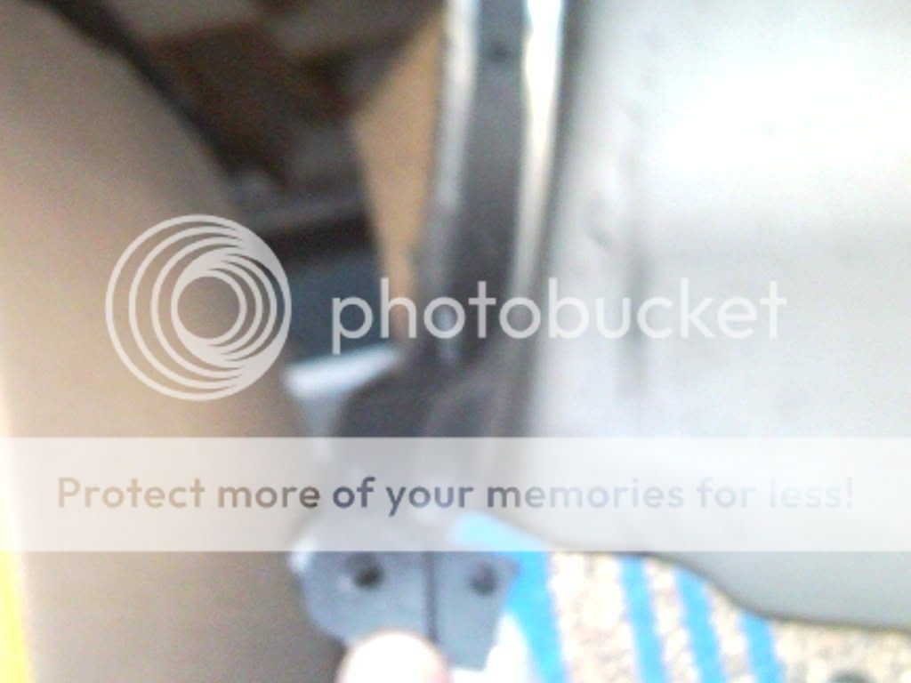

What the heck, how hard can it be to install an oil pan gasket with the motor out?
I have the Fel-Pro 4 piece pan gasket and I lay it out and I see the corners want to over lap? Over laping a cork gasket & rubber gasket don't sound like a good plan?
Trim it? If I over lap it which goes on top?
Also every where I look on line everyone has a different idea as using sealant, when, where, how much.
I DON'T wish to have to do this twice so I want to get it right the first time. I still need to clean the old gasket off the block but I'm wanting to get the pan on and the intake on today before it reaches 105 degrees!!
Ideas?
It does the same in the rear???

Donny, lay the cork on the block. Then install the rubber into its grooves or tabs which overlaps the little tabs on the cork. The rubber has a notch for the tab to fit into. Use some RTV on both sides of the overlap. Don't go crazy with it or the cork will slide and tear.

No just the corners. If you silicone the cork it will squeeze out and tear when you tighten the pan. Have the pan and block surfaces clean and dry. I usually wipe them down with lacquer thinner or equivalent.
x2, but I like to use something like Hi Tack, or Indian Head Sealant on cork to keep everything in place.:texas:
