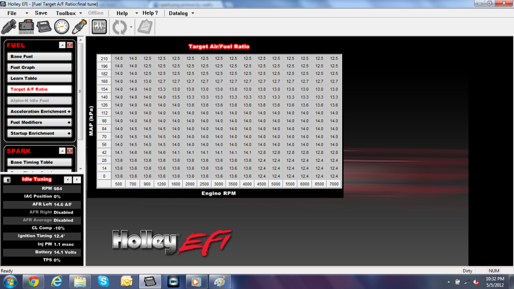

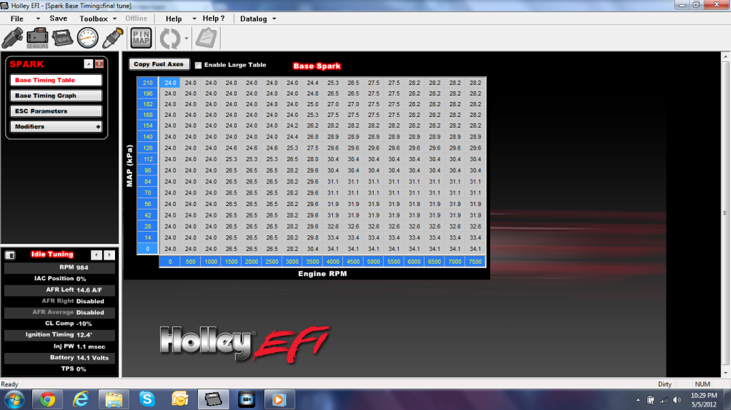

I just got my 383 SBC up and running again. I'm using Holley's EFI system with computer controlled timing. I think I may have my timing off a bit. I'm getting a loud pinging/popping sound from the engine whenever I try to give it gas when the RPM's are real low or when I gas it in a higher gear. I don't see anything out of the norm with my timing. I feel like I've had this problem before but I can't remember how I fixed it. Any advice?

I'm breaking in the motor without the blower and I'm running 91 octane instead of E85. It did sorta sound like a backfire from the intake but I'm not 100% sure. I'll see if I can try and duplicate it again with a video and post it on here. Then I'll back the timing off a bit.

oh ok i see now. did you back off the base timing?
add some fuel to it and pull out about 3 degrees and see if it likes it hope it helps
OK, I'll try that out. I gotta put a couple of the spark plugs back in from checking them last night. They look fine. I'll let you know how it goes.

**UPDATE**
So I kept messing with the timing and fuel and I couldn't get the pinging to go away. Also the throttle was still really twitchy. So I called Holley' Tech line and they had me email them my tune and datalog. I got a call back within an hour saying my idle was all jacked up. Basically I had my ECU idle set to 900RPM but my throttle bladed were open too much and I was idling around 1100-1200. So my idle air controller (IAC) was constantly closed because it was trying to compensate for the extra air coming in. After a while, the ECU was trying to pull timing to bring the idle down. He had me close my throttle blades until the IAC read about 30% at idle on the Holley software. After that, the pinging went away and the throttle is super smooth coming off idle.
