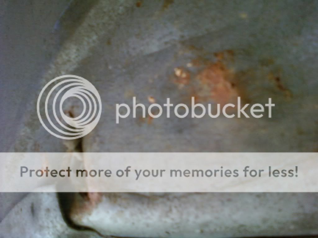

Even CA cars are not safe, looks like something punctures the floor board and was just sealed with silicone which probably led to rust next to it
