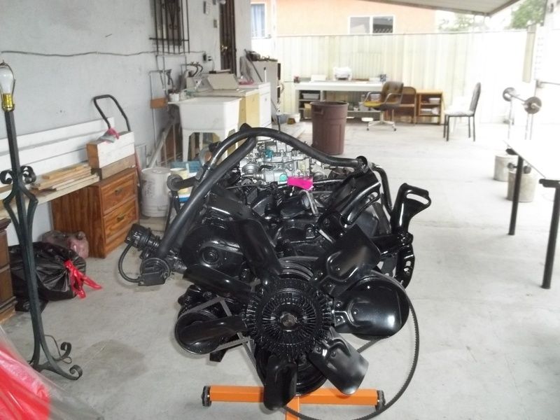

The time has finally came today is the day to drop the new 350 in. So far everything has gone by plan and I haven't had a single bolt that didn't come off with ease. The exhaust manifold bolts were a piece of cake but I soaked them every day for a week .
here's what she looks like:nanawrench::nanawrench::nanawrench: I like my women like my coffee BLACK:poke:

O.k. as you all know there's always something that hangs you up doing a motor swap but this ones a winner. I bought almost everything new down to new motor mounts except a oil filter adapter. What for use the old one RIGHT!!!! I HAVE HAD TROUBLES GETTING OFF AN OLD OIL FILTER .
If all else fails use a screw driver but this filter wouldn't come off no matter what. We destroyed it and still couldn't get it off. Went and bought a new one and asked what screws were needed and the guy blew me off got home and found some that would work so done with that. Now trying to line up the motor to the mounts isn't going good but finally were on got one side bolted up but can't get the hole on the passenger side right. Looking we have the motor mount upside down O.K. TIME TO STOP FOR THAT DAY . SORRY MEANT FOR THE NIGHT
Does anyone think we can lift that side and flip it over or is it better and faster just to pull the motor and fix it ?
I'm really proud of myself in the heat I held my composure stayed calm and said we can fix it tomorrow.

You bet I knew after finding the problem and it starting to get dark it was time to quit. Once seeing all this for the first time it's not really a problem doing any of this it's all in knowing in what your doing.
Thanks Donny will be back with the results soon .:nanawrench:I still look like this:nanawrench: hopefully not like this later :let_it_all_out:

We fought that motor for hours before noticing it was installed upside down.:dontknow: We just lifted the one side and flipped it over in a 1/2 hr max.
