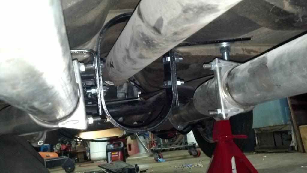

Figured I'd be taken her to the track so I put a driveshaft loop in

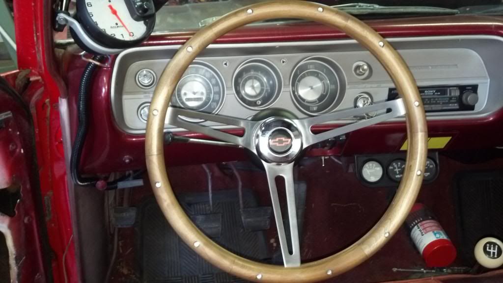

Mounted a new Autometer Tach

New Grant Steering wheel
