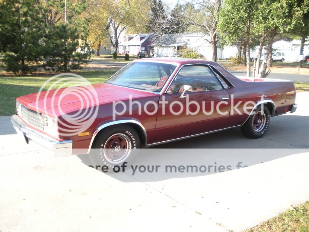

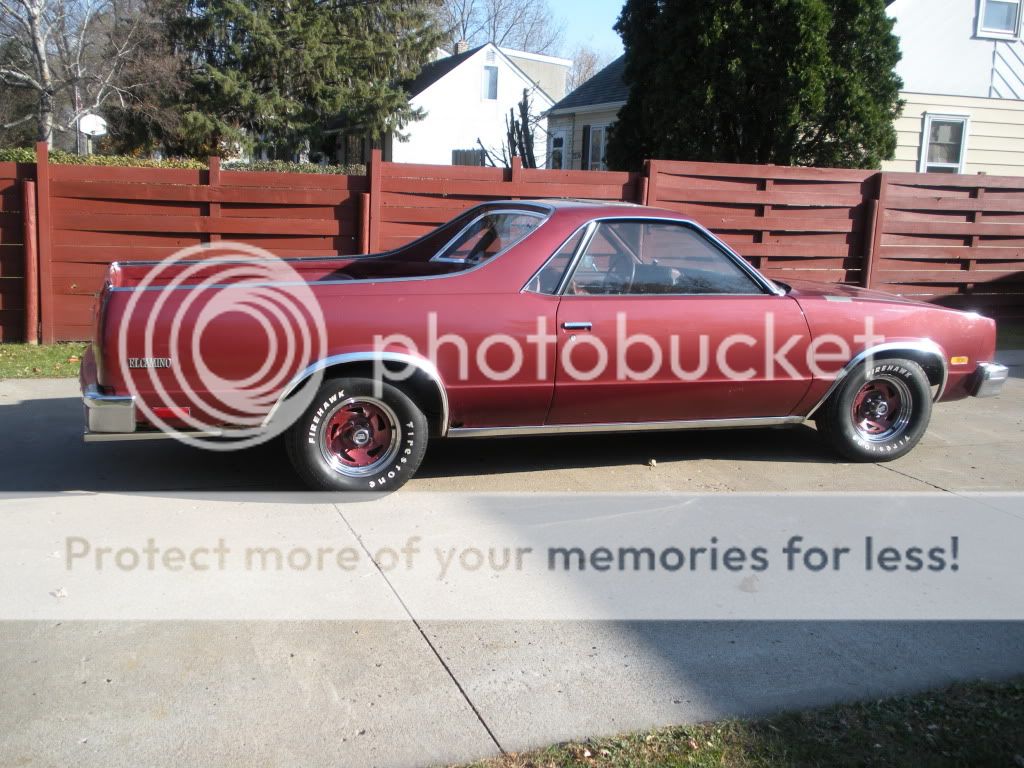

Here's basically what it looked like when I first got it. 1984 el camino with a mild 350 sbc and th350 out of a 1970 caprice. Rest was all stock except for the leaky sunroof that someone put in at some point in time.

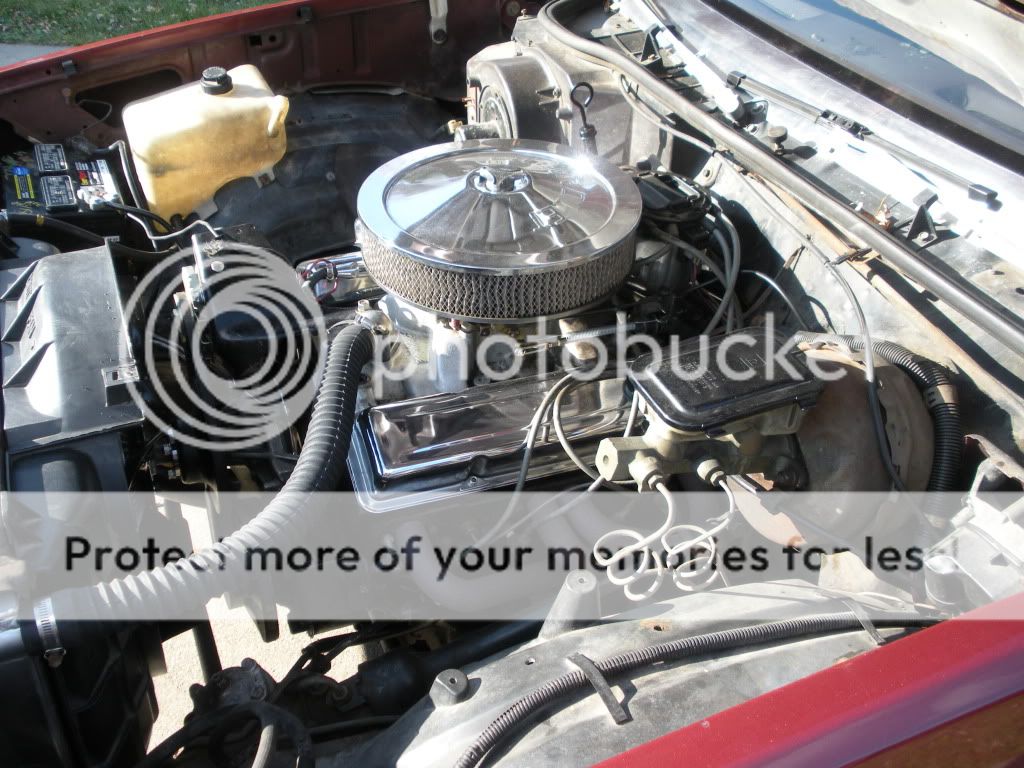

Also I was having some overheating problems (probably why the trans burned up) so I put in a new water pump, fan clutch, and aluminum radiator. Also installed a transmission cooler to keep the temps down. Now the highest I have seen the gauge go is 180 and that is only when it's hot out.
New radiator, water pump and fan clutch. Trans cooler is mounted in front of the radiator and run inline with the radiator.

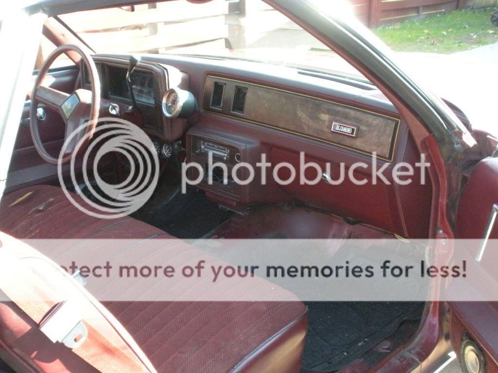

The next thing I did this past summer was install the 1980 grand prix dash I have had laying around for a couple of years. Got that along with the center console and tilt column out of the junkyard for $100. No cracks on anything.
Here's a pic of the dash before I had everything installed and wired. It's all together now but I don't have any recent pics of it. Also I just temporarily zip tied the old tach and gauges I had to the face plate but now I am using the original gauges.
