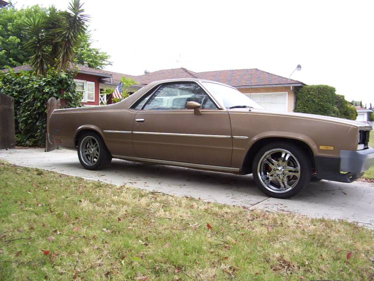

4x4 look that is. I installed a set of Eibach Pro Kit springs. I finally got tired of the rough ride and the look. Before measurements to the top of the wheel wells were: 26 1/4 front and 26 3/4 rear. After measurements are: 25 1/2 front and back. I was very surprised that the front didn't drop more until I remembered 2 things. 1. I removed the front steel bumper a few weeks ago and that took 47 lbs off the front, the new bumper and steel probably only added back 10 or 15 pounds. 2. I don't have the all of the air conditioning parts installed so thats probably another 30 lbs that's off the front. There may be a set of drop spindels in the future. I already have just short of 100 miles on the new springs so I don't know if they will settle anymore or not.
Before :(
After 8)
