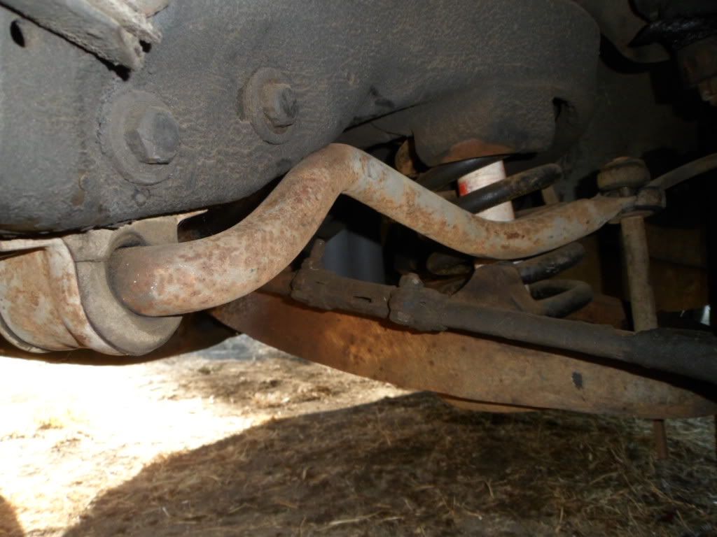

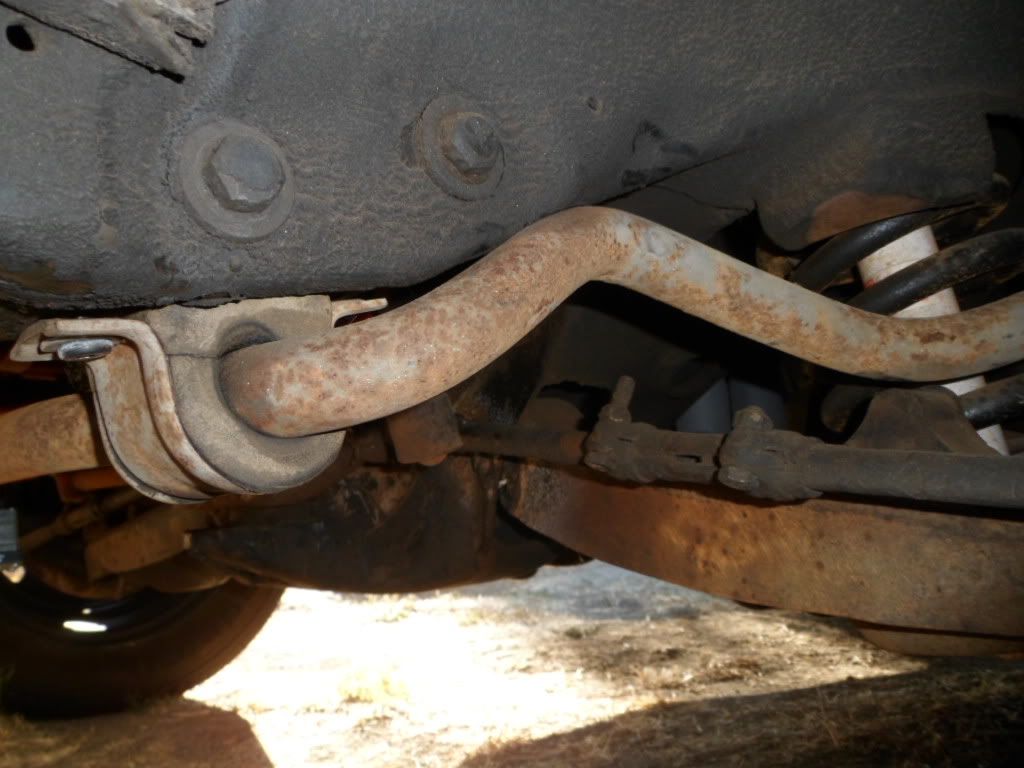

This sway bar was actually behind the seat when i bought my truck 6 months ago. I put it on and it seams like its wrong. I dont think its original. Its 1" thick, solid, and is contacting the frame-rails where it bends. It works, but seems wrong. Do i have it up-side-down? Someone i asked about it thinks its off a camaro maybe.... Any ideas?

"play around with it a little" ---- try it that way, try it upside down, both ways with shorter links. Looks like it should fit, but links look too long to me

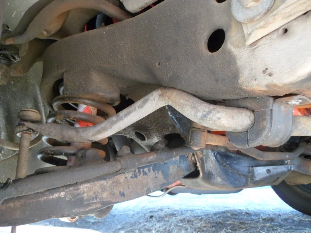

No, no stay at home family/friends, unfortunately. I'll have to just have it shipped to work. But, meanwhile, on the front end... I just finished re-installing my front sway bar(the right way) with new MOOG end links. It fits great. The new end links are shorter than the ones that were already there, so they actually fit and move the bar down a bit, placing it correctly. The first time i tried to install this bar, the steering tie-rod ends hit the sway bar (well, one of the bolts on the tie-rod hit the sway bar at complete turn) and thats the main reason why i thought it should have been flipp'd and did it, but then it was in contact with the frame and i really didn't have the desire to flip it again....till now. Its a pain in the arse for sure to line up the bolt holes on the frame bushings. Anyway, here is the before and after pics....it's a bit obvious NOW, but wasn't soo obvious back when i did it originally.
BEFORE:
NOW:
