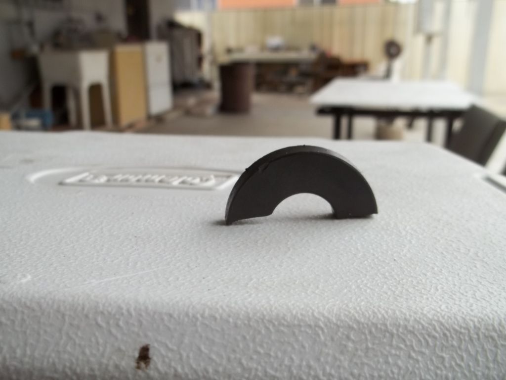

Just wanted to change the lock-up connector and found this in the pan. How bad am I ? Driving I haven't had any problems that I could feel or hear and all gears work but this is definitely 3/4 of a complete circle. Is this going to the shop to be fixed or could I catch a break and something I can do myself knowing nothing about transmissions? Sense it hasn't been an issue till now can I do my motor swap and put it back together and then take it in if needed or this is not supposed to be touched till fixed or I will just cause more damage even driving two miles to the shop? I'm going back out and swap more oFF the engine so at least I can pull the motor this weekend and tranny if needed. Like they say about this hobby MO MONEY!!!!!!!!!!!:nanawrench:There's nothing else in the pan but a little sediment no metal looks clean.
hkdup that is a magnet placed in the pan to catch metal shavings n debris
just clean it up good and put it back in the pan when you reinstall it no issues to be alarmed of at this time, UNLESS there where alot of metal shavings, a small amount and some blackish smudge in the bottom of pan is normal, as long as it doesnt look like glitter you should be fine.:beer:

The magnet was broken but I don't see the other piece. I was freak'n out $$$$$ I couldn't see how a piece that big fell out it doesn't look like there's a space big enough for it to fall into the pan. There was a little black sediment but nothing shinny but there were a couple of maybe plastic slivers I have a picture but I need to down load a video and a bunch of pictures tagging vacuum hoses and connectors to the cab. that is ready to come off and put on it's new motor. Also cleaned the trans. pan and painted the outside of it to take my mind of what I was going to find out from my post. What a relief . Last night was the balancer not being right but I fixed that by ordering timing tape and an engine stop. Later I found the correct balancer and it looks like I can ride my bike to get it .:beer::beer:

Thats similar to the tin foil hats people wear to prevent mind control by aliens.
Its used to intercept magnetic brain waves so you can think clearly.:secret:
No really, just a shavings magnet like everyone else said.

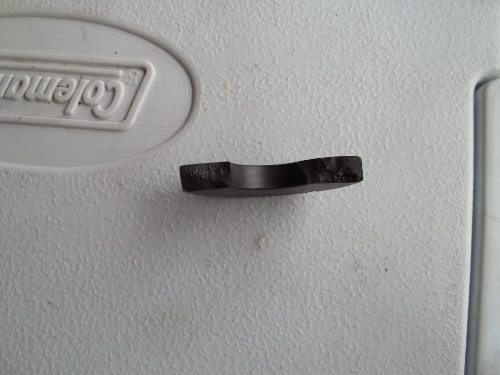

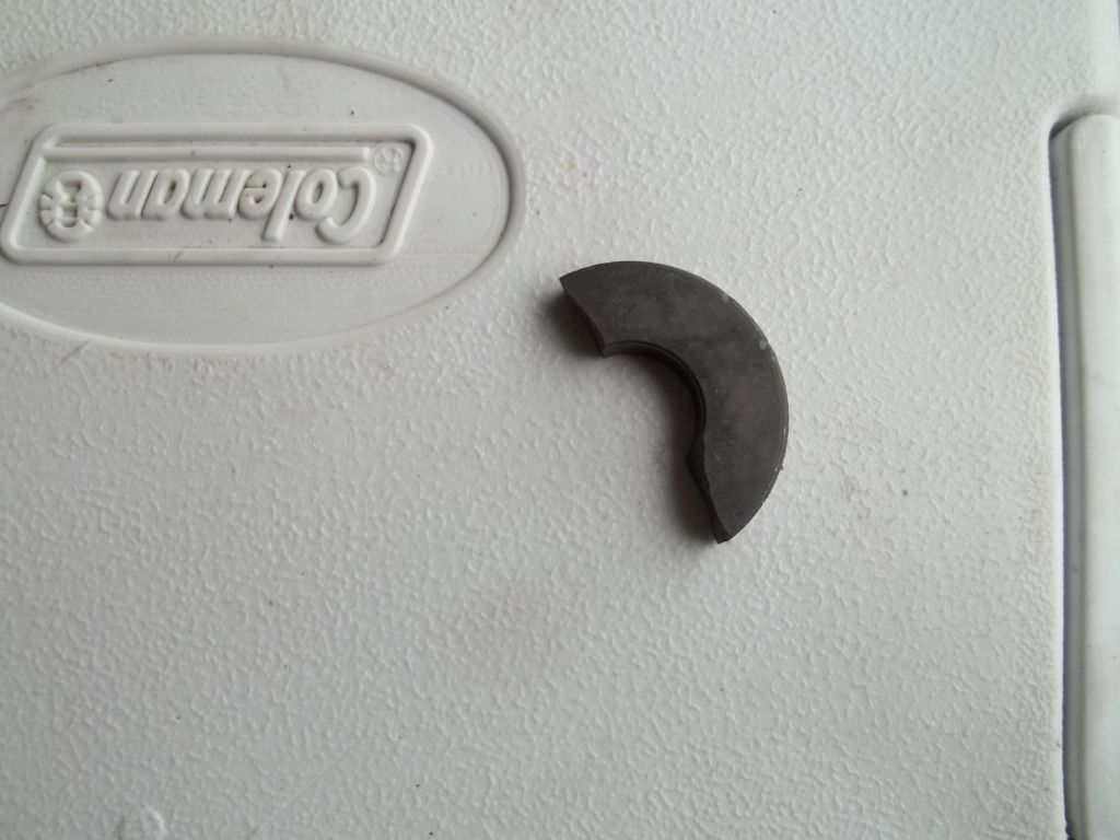

I did find this looks like plastic or fiberglass?

petrified pan gasket or maybe part of the piece between the trans and valve body? :dontknow:
The gasket was all in tack with gray silicon.:dontknow:
it looks like left over gasket sealer as mentioned above. i dont remember any red rings inside the trans. they look too random a shape to be a seal. send trany mike a pic and see what he says. they used two types of magnets in the trans. a round one like what you have half of and a flat synthetic one about an 1/8 thick and 1 1/2 in square. the pans that use the round one will have a dimple to keep the magnet in place near the back of the pan.the synthetic one will have its outline indented into the pan

Those pieces are a thrust washer coming apart. You need to open her up and see what washer it is.
I just put it back together on the 4th. My life story but there's no oil in it. Can I see it or just take it in? Doesn't look like something I can do just changing the filter it looks like complicated workings.
