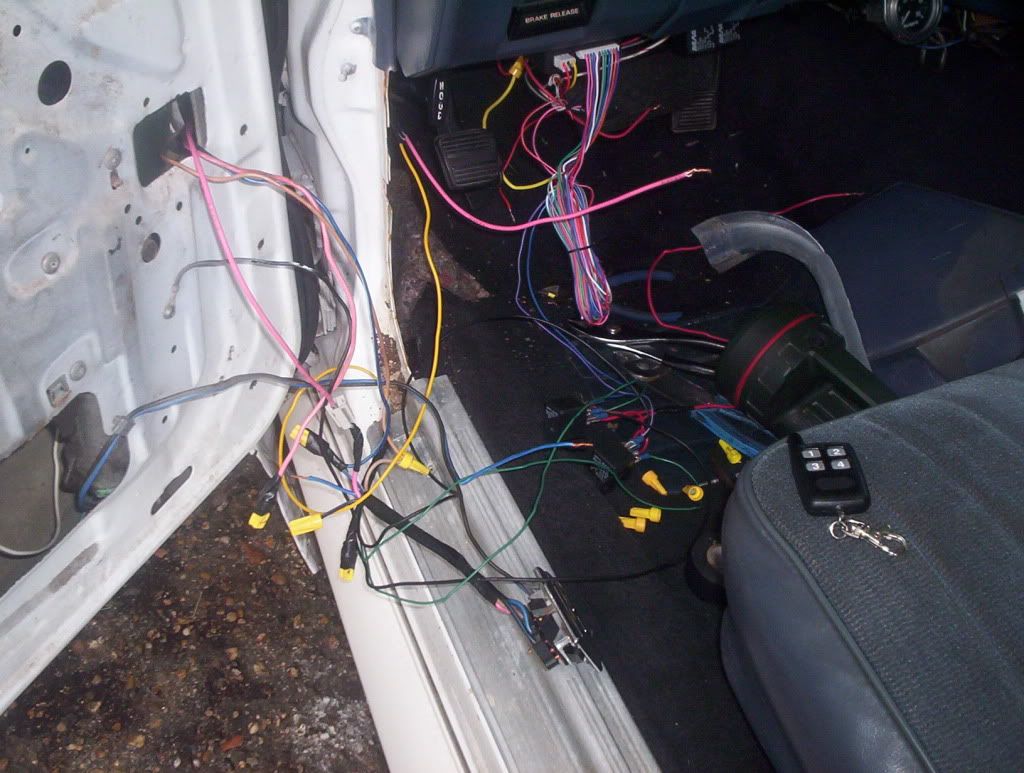

It looks like a mess, but I'm taking it slow and locating and connecting one wire at a time. I have to cut in the 2 relays between the window switch and motor. I hooked it up and it works!! Press pad #3 on the key fob and the window goes down, #4 raises the window. New wires have to be routed by the kick panel and thru the door, and a new power wire has to be routed to the fuse panel with an in-line fuse. Has anyone every seen this modification on a vehicle?
