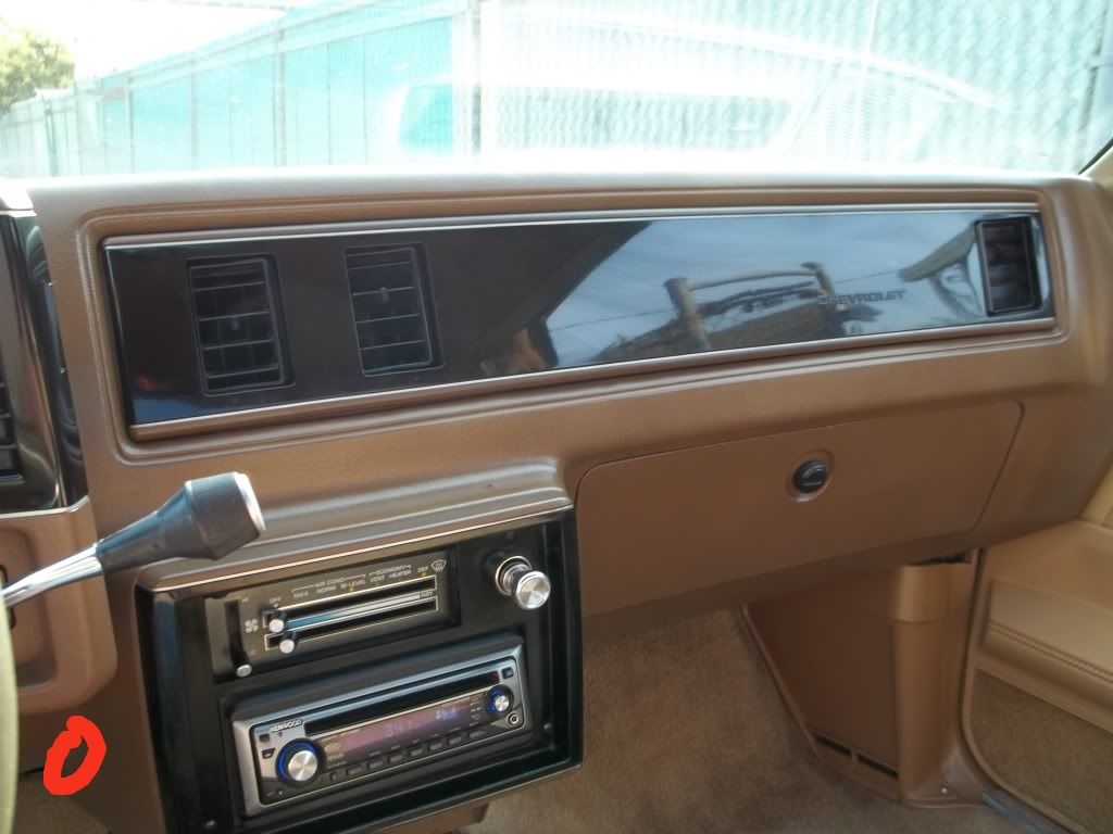

Mine is just under the dash when sitting in the drivers seat the panel by your right leg and the stereo there's a steel plate behind the plastic with a perfect round hole that I installed a push pull switch. Just cut the yellow wire and your done. $4.00 You have to lean foward to pull it.:poke:
