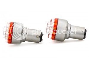

Did you swap to LED bulbs if so some brands will do weird things ?
#22 · (Edited)
doesn't matter they make led's for those and other sockets.
Tail Light Load Resistor Kit
