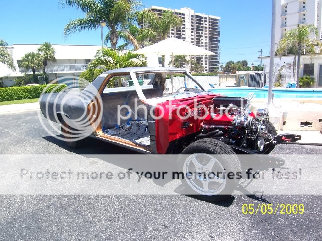

Front clip is off, new motor 383 stroker, 450hp.
All new suspension, 12" drilled and slotted rotors, 3 piston calipers.
I think you got the idea, new and upgraded front end.
The front fenders and the rest of the car was Soda Blasted.
Now at the painter, I will be paying big bucks to have it done right!!!!!!
When painter finishes parts, I will be putting back together.

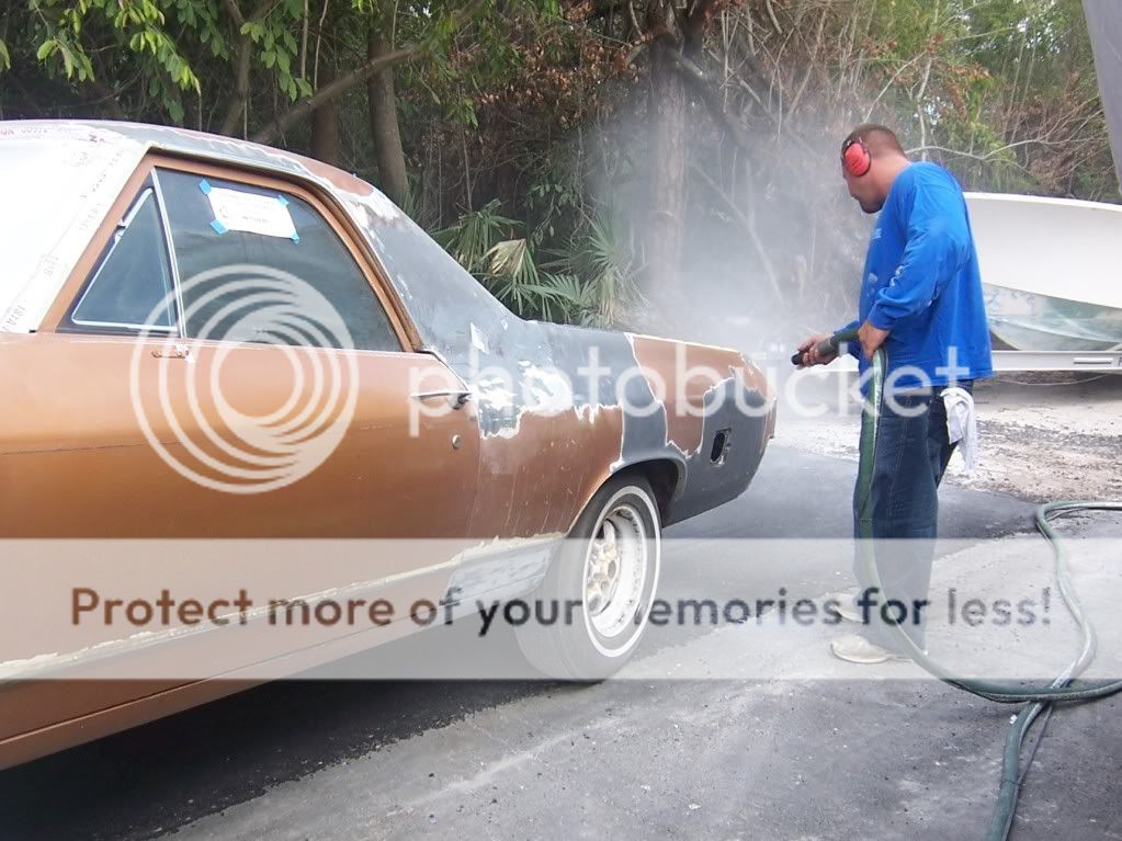

Old paint blasted off!
Waiting for tow truck to go to Ron's Body Shop.
Primer and Sanding....Super Red GM paint ...soon...:smile2:

You are correct, no roughness at all.
The blaster doing mine ran out of soda with just a small area of the fender not blasted.
He put silica in the hopper and blasted the rest of the fender...yes, that small area felt like sandpaper!

When the Baking Soda particle hits the paint it explodes into DUST...The explosion is what removes the paint...Unlike Silica, Soda turns to dust and can be blown away with a little air. The dust on the ground is gone with the first rain...is that cool or what?
When I got the car home I wiped it down with phosforic acid. I don't think I spelled phosforic right.
I put rubber gloves on and soaked a rag with acid and wiped it down...about a half hour. The car is 300 feet from the Ocean and 3 days with no rust...no telling how long it could remain outside in its bare naked metal without rust forming.

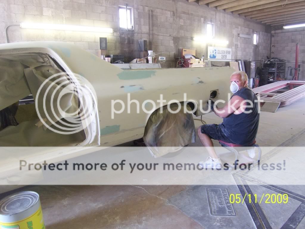

This is what it takes to make it smoooooth (straight as an arrow)...
BLOCK sanding...forever...don't give up. Prime again, sand, sand, sand.
I think I have spent most of my life sanding...I remember the time I put drywall on the ceiling and walls of my garage, then several thousand square feet in my house...not to mention my boat...sanding, sanding!

Painter took a few days off...(clearing his lungs from all the sanding dust). He said he will put the first coat of paint on it Monday or Tuesday.
This pic shows the body after block wet sanding with 500 paper. It is starting to SHINE!
